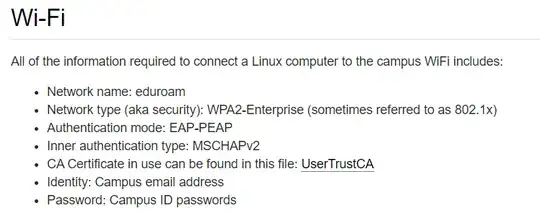

Here are the connection instructions supplied by my institution:
Instructions for connecting
These exact instructions, except for adding the certificate, were all that was necessary to connect to the network under 21.10. However, the same connection options no longer work under 22.04. I also tried adding the certificate and the same behavior still resulted.
