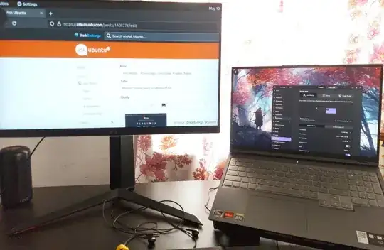

I have a Lenovo Legion 5 Pro with Ubuntu 22.04 with an external monitor (Lg UltraGear 24GN650). I connected to my laptop and the monitor works but laptop is 4k 2560 x 1600 and my monitor is 1980 x 1080. I need to scale my laptop a bit so that I can see things a bit bigger than they are but as soon as I do that, the monitor gets zoomed in too even though in the settings, it is at 100%.

Image of the scaling issue enter image description here
While switching between monitors I also notice considerable amount of lag.
