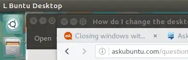

It appeared that, The Text on top-left corner uses the value from the file /usr/lib/os-release file. So, We need to edit the value for NAME key on that file only.
  1. Open with nano
    sudo nano /usr/lib/os-release
  2. Change the value of NAME from the first line. I changed it to L Buntu just for testing. The file's content after change
    NAME="L Buntu"
    VERSION="16.04.1 LTS (Xenial Xerus)"
    ID=ubuntu
    ID_LIKE=debian
    PRETTY_NAME="Ubuntu 16.04.1 LTS"
    VERSION_ID="16.04"
    HOME_URL="http://www.ubuntu.com/"
    SUPPORT_URL="http://help.ubuntu.com/"
    BUG_REPORT_URL="http://bugs.launchpad.net/ubuntu/"
    UBUNTU_CODENAME=xenial
  3. Logout and Login again to see the change.
    Here is a tiny screenshot after change.
Tested on 16.04.
