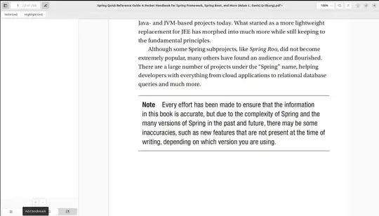

I have a problem with Ubuntu Document Viewer. There is no possibility to add bookmarks to documents because button "Add bookmark" is disabled (see attached screen):
Screen of document
It's strange because the problem arises after reinstallation of VM Ubuntu. There was no such problem at my first VM Ubuntu. I searched solution of this problem but couldn't find it. I will be pleased for any idea how to add bookmarks.

Had the same issue myself. Furthermore, previous bookmarks I made were not saved. Found the solution in this thread
This command solved the problem:
sudo apparmor_parser -R /etc/apparmor.d/usr.bin.evince
