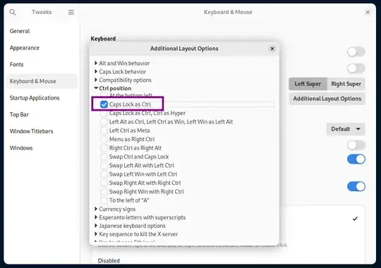

  1. Move to Xorg: Log out, click the cog wheel to change to the session Ubuntu on Xorg before entering your password, then log in.
  2. Stay on Wayland and achieve an effect that comes rather close to what you had with xcape: in GNOME Tweaks, head to the Keyboard & Mouse tab. In Additional Layout Options there is an option to make CapsLock an additional Ctrl:
    Additional Layout Options window with Caps Lock as Ctrl highlighted
    You then only lose the possibility to use that key stand alone as Esc.
