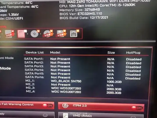

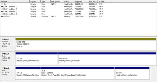

So this is what I have:-

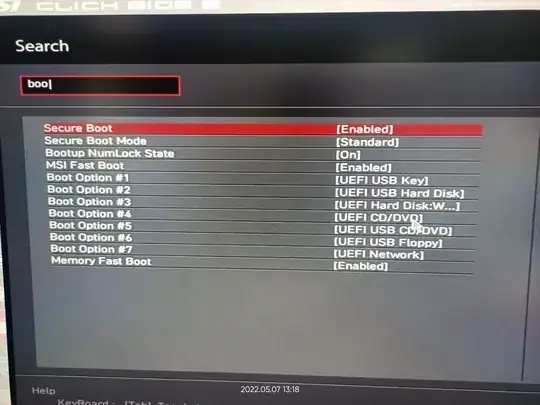

And this is what my BIOS boot options look like:-
