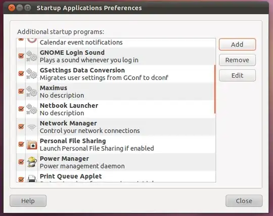

If you want to autostart Chrome when logging in, follow this steps:
  • Go to the Dash, and open Startup Application Preferences. It should appear a window like this:
Startup Apps!
  • Press the "Add" button.
  • In the "Command" field, paste the following text: google-chrome. Put what you want in "Name" and "Comment". Press Save.
Ready! Now every time Ubuntu boots, you'll be able to directly browse from Chrome :)
