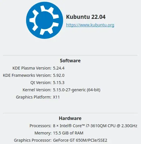

I've recently upgraded to Kubuntu 22.04. I've attempted several times to set Firefox as the default browser in about:preferences without success. I select 'Make default', then 'yes' to 'Allow settings change', but the message, 'Firefox is not your default browser' persists.

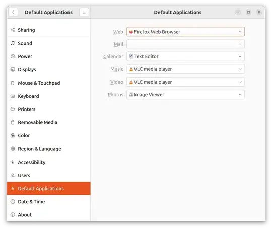

You can set it in the Settings app under Default Applications
