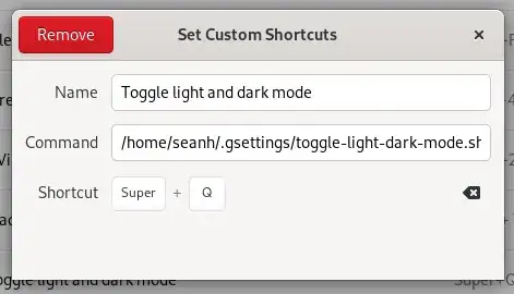

You can create a custom keyboard shortcut for the script in the Settings app (under Keyboard → View and Customize Shortcuts → Custom Shortcuts):
(In the screenshot I've saved the script at ~/.gsettings/toggle-light-dark-mode.sh and made it executable by running: chmod u+x ~/.gsettings/toggle-light-dark-mode.sh.)
