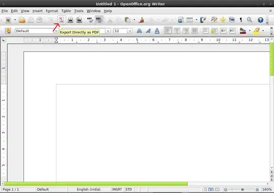

First print your document as pdf and then you can convert it to jpg or png using GIMP.
Printing your document as pdf:
Open your document in open office,and then click pdf option to export your document as pdf or goto file menu and choose export as pdf.
alt text
Converting pdf to jpg|png:
Open your pdf in GIMP(Right click your pdf and then choose Open with GIMP Image Editor)
Now again goto file menu and select the option save as,Now be sure you choose the correct format.Choose JPG or PNG to save that pdf file into image format..
