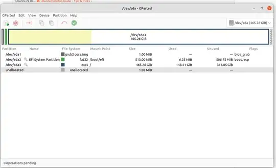

i want to dual boot windows with ubuntu but i need to shrink my partitions. I only have one partition and a total of 1 MB of unallocated space please help i have no idea what i am doing. Here is and screenshot of GParted to show what i have. i haven't really tried anything yet because i am very confused. i have done some research but it looks like i either have to wipe my hard drive or have enough space for another operating system. as i cant do the latter i would like to look for some more solutions before i try the former. i cannot shrink my partition unless i have it unmounted, which i cant do if i dont have any other OSs installed

To do this you will have to boot from a USB. Then you will be able to change the root partition size (ie reduce it). However, as has been said, be very very careful. I would backup any data I wanted to keep.
I know its more long winded, but there is a safer way. That is to backup your data. Then delete the boot partition and recreate it as a smaller partition. If all you care going to have is the ubuntu root, then much smaller is just fine, say 16GB? It can be smaller, but it depends on your usage.
I would ALWAYS advocate putting /home on a different partition. That way you can do what you like to the boot partition but still retain your data.
