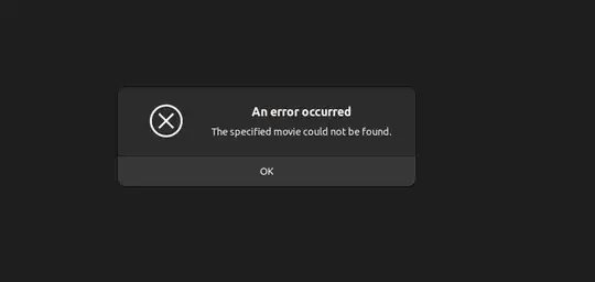

The default video player (Totem) is unable to play videos after installing Ubuntu 22.04. I tried opening an MP4 file and I get the error (also shown in the screenshot):
An error occured
The specified movie could not be found.
error in default video player
I also tried installing ubuntu-restricted-extras, but it's still not working.

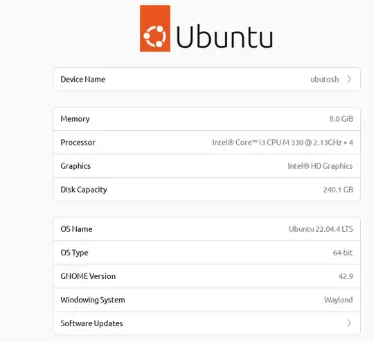

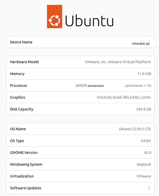

My system's details:
Settings About

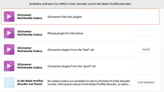

I tried opening the file using the Ubuntu File Explorer (I think it is called Nautilus). But I got the same error the OP pointed out but there was a popup that said something like Install from the Ubuntu Software Store. The GUI looked like this, and I installed all of the choices that were not greyed out.
This didn't work, the video still did not play.
Fixing this
The solution (for me) was to install vlc. After I installed vlc using
sudo apt install vlc
Then both vlc SampleVideo_1280x720_20mb.mp4 worked, but also double-clicking on the file icon in the File Explorer also worked (and opened a different video player).
