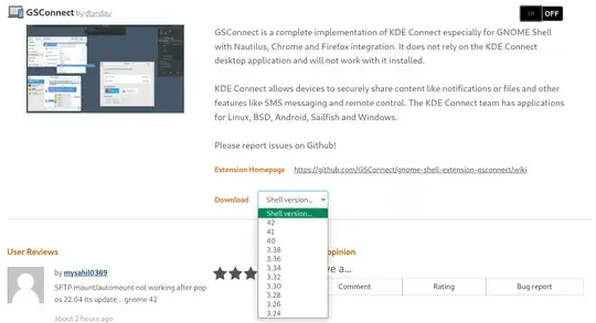

GSConnect does actually support GNOME 42 and Ubuntu 22.04, as you can see in the extension's webpage:
GSConnect supported versions
The issue of not being able to install the extension using Firefox exists because, since Ubuntu 21.10, Firefox is a snap application. The Firefox snap, however, is not configured correctly, so it doesn't let you install GNOME extensions.

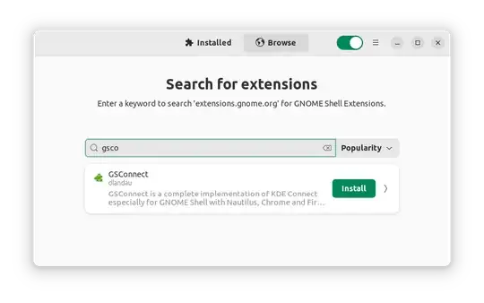

  1. The recommended way to install GSConnect in Ubuntu 22.04 is to use GNOME Extension Manager, which you can install by running in a terminal:
    sudo apt install gnome-shell-extension-manager
    Then you can open the Extension Manager, click on the Browse tab, search for "gsconnect" and install the extension.
    Extension Manager
    If you had the extension already installed, try to remove it, log out and log back in, and search for it again.
