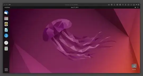

  1. Success: Ubuntu Desktop 22.04 on macOS Parallels ARM64

  1. Worked for me!
