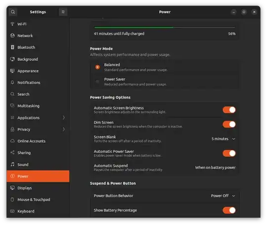

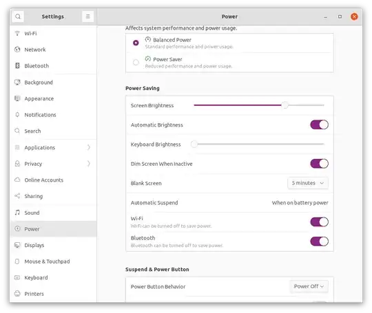

Is this an intentional change in 22.04 LTS? Or is something just not recognizing the hardware correctly? Previously, I had both a Screen Brightness and Keyboard Brightness slider visible under Settings > Power. Those no longer appear in 22.04 LTS. BTW: I tried disabling the Automatic Screen Brightness (especially since my device doesn't support the capability) but that didn't cause any sliders to be revealed.

        That could be an intentional change. Few people are go to hunt so deep to change brightness, so it makes sense to have the control just there under the system button in the top right corner.
