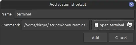

I want to add exact steps, for anyone finding this later.
  1. Add this script ~/.scripts/open-terminal:
    #!/bin/bash
    PID=$(pgrep -x gnome-terminal-) if [[ $PID -ne "" ]] then xdotool windowactivate xdotool search --pid $PID | tail -1 else gnome-terminal fi
  2. Make the script executable: chmod +x ~/.scripts/open-terminal
  3. Go to the keyboard shortcuts and add the script to a key of your choosing (mine being Ctrl+Alt+T)
  4. Your hotkey should be ready
