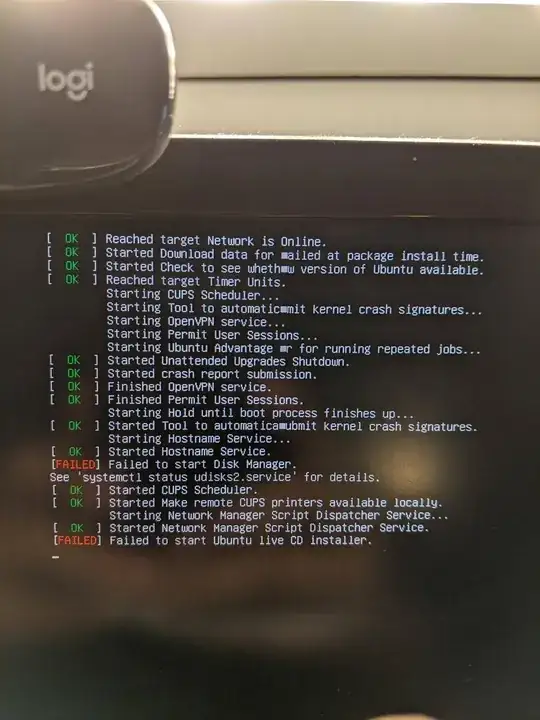

Also, ubiquity crashes on BaseCamp. I submitted the crash report using the apport dialog. Potato quality picture here: potato_quality_picture
As suggested by @user535733 in the comments, systemd-analyze critical-chain looks like this:
ubuntu@ubuntu:~$ sudo -i
root@ubuntu:~# systemd-analyze critical-chain
The time when unit became active or started is printed after the "@" character.
The time the unit took to start is printed after the "+" character.
graphical.target @9min 59.900s └─multi-user.target @9min 59.900s └─casper-md5check.service @44.452s +9min 15.447s └─basic.target @44.448s └─sockets.target @44.448s └─snapd.socket @44.448s +519us └─sysinit.target @44.444s └─snapd.apparmor.service @38.751s +5.693s └─systemd-journald.socket @5.116s └─system.slice @5.113s └─-.slice @5.113s
And here's the output of systemctl status ubiquity:
× ubiquity.service - Ubuntu live CD installer
     Loaded: loaded (/lib/systemd/system/ubiquity.service; enabled; vendor preset: enabled)
     Active: failed (Result: exit-code) since Tue 2022-04-26 16:36:07 UTC; 16min ago
    Process: 1731 ExecStart=/usr/share/ubiquity/start-ubiquity-dm (code=exited, status=1/FAILURE)
   Main PID: 1731 (code=exited, status=1/FAILURE)
        CPU: 2.729s
Apr 26 16:32:10 ubuntu systemd[1]: Starting Ubuntu live CD installer... Apr 26 16:35:24 ubuntu python3[1752]: PAM pam_end: NULL pam handle passed Apr 26 16:35:27 ubuntu systemd[1]: ubiquity.service: Main process exited, code=exited, status=1/FAILURE Apr 26 16:36:07 ubuntu systemd[1]: ubiquity.service: Failed with result 'exit-code'. Apr 26 16:36:07 ubuntu systemd[1]: Failed to start Ubuntu live CD installer. Apr 26 16:36:07 ubuntu systemd[1]: ubiquity.service: Consumed 2.729s CPU time.

Update: I'm starting to think the ubiquity crash is Wayland-related since BaseCamp also crashes with a black screen on 20.04 LTS. I install gnome-session-wayland, reboot, then pick "Ubuntu on Wayland" session at the login screen, login, and poof everything turns black. Fortunately I can SSH from my laptop to it to issue a sudo reboot.

Naive question: Looking at the output of systemd-analyze critical-chain is it not the case that almost 9 mins of your boot is due to disc checking? If that is the case, is it possible to disable that part of the boot? -- Disable Ubuntu 20.04 disk checkup every boot?
Another solution could be testing the speed on your USB stick and trying to see how it matches up to others, especially if upgrading to 3.0 is a possibility.
