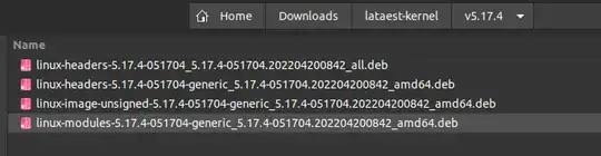

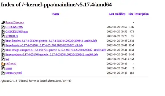

@Pilot6 recommeneded to get latest mainline kernel
I got these files latest kernel files
from (https://kernel.ubuntu.com/~kernel-ppa/mainline/v5.17.4/amd64/) enter image description here
Got below error (see full response here) after running sudo dpkg -i *.deb
dpkg: dependency problems prevent configuration of linux-headers-5.17.4-051704-generic:
 linux-headers-5.17.4-051704-generic depends on libc6 (>= 2.34); however:
  Version of libc6:amd64 on system is 2.31-0ubuntu9.7.
 linux-headers-5.17.4-051704-generic depends on libssl3 (>= 3.0.0~~alpha1); however:
  Package libssl3 is not installed.
dpkg: error processing package linux-headers-5.17.4-051704-generic (--install): dependency problems - leaving unconfigured Setting up linux-image-unsigned-5.17.4-051704-generic (5.17.4-051704.202204200842) ... I: /boot/vmlinuz.old is now a symlink to vmlinuz-5.17.0-051700-generic I: /boot/initrd.img.old is now a symlink to initrd.img-5.17.0-051700-generic I: /boot/vmlinuz is now a symlink to vmlinuz-5.17.4-051704-generic I: /boot/initrd.img is now a symlink to initrd.img-5.17.4-051704-generic Setting up linux-modules-5.17.4-051704-generic (5.17.4-051704.202204200842) ... Processing triggers for linux-image-unsigned-5.17.4-051704-generic (5.17.4-051704.202204200842) ... /etc/kernel/postinst.d/dkms:

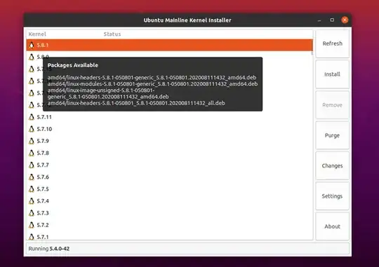

To downgrade the kernel I used a tool called Ubuntu Mainline Kernel Installer.
Install with:
sudo add-apt-repository ppa:cappelikan/ppa
sudo apt update
sudo apt install mainline
Ubuntu Mainline Installer
You can then use the tool to look for any 5.10 kernel version you desire, and install it.
Then reboot and make sure to select Advanced Options for Ubuntu in the GRUB menu before loading into the OS, in order to select the older 5.10 kernel.
After doing so, your wifi should already be detected and working.
If you so desire, you can delete / uninstall the newer 5.13 kernel.
I will note that downgrading the wifi card's firmware would also work in this case, without having to downgrade the kernel. But I found downgrading the kernel to be quick and painfree.
