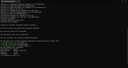

I just installed Ubuntu 22.04 LTS for Windows Subsystem for Linux, but I'm having some issues. Every time I install new packages using sudo apt install, I will get 2 messages saying that:
Failed to retrieve available kernel versions.
Failed to check for processor microcode upgrades.
This issue doesn't happen when using Ubuntu 20.04 LTS.
Even though I get these messages, I can install Linux packages and integrate them into Visual Studio Code successfully. And when I check the kernel using uname -r, I get 5.10.102.1-microsoft-standard-WSL2.
Everything works fine, but these messages keep concerning me.
I am wondering why these messages appear and how I can fix them. Can anyone give me some suggestions to fix these issues? Are these messages fatal?

Short answer:
sudo -e /etc/needrestart/needrestart.conf
Note: -e uses the default system editor. If you want to use a different editor, simply run sudo update-alternatives --config editor
Uncomment and change the following settings:
$nrconf{kernelhints} = 0;
$nrconf{ucodehints} = 0;
You will no longer get those warnings when installing packages.

There's really nothing to be concerned about. This is a (recently) new check done by Ubuntu after installing packages to determine if other actions need to be taken.
The package that handles this (and is causing those warnings) is needrestart. From apt show needstart:

Neither the kernel nor microcode under will ever report correctly under WSL2, since we are running Ubuntu in a container inside the WSL2 VM (that we can't access). However, given the information above, there may be some scenarios in which it could come in handy, depending on what other daemons or containers you run.
You can continue to use the rest of the features without the kernel/microcode checks with the configuration file changes above. Whether or not they are useful will depend on your WSL2 use-cases.
