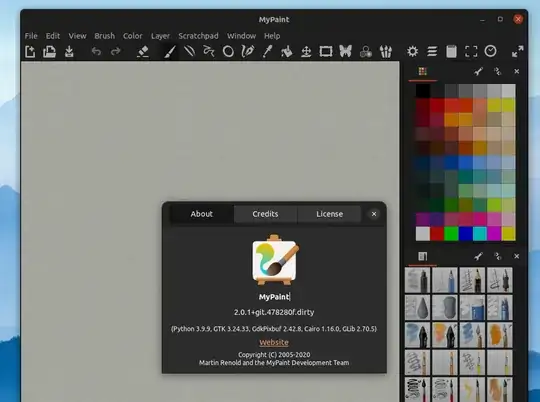

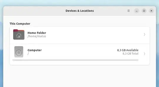

For example baobab uses gtk4 and does not follow the system theme, while mypaint uses gtk3 and follows the system theme.
baobab mypaint
