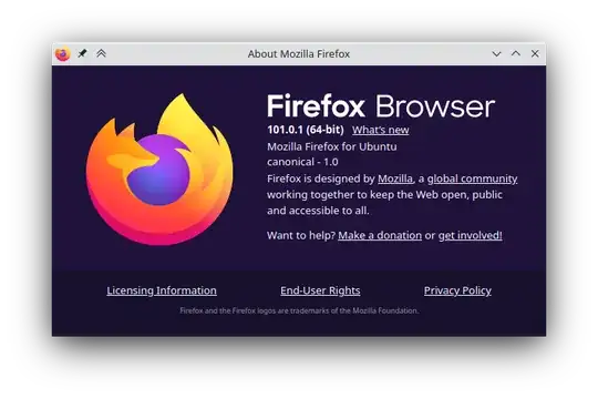

  • You can check whether you are running the Snap version or the regular version of Firefox by opening Help -> About Firefox. If the version number doesn't mention "Snap" you are running the regular version: enter image description here

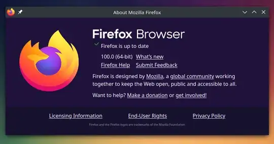

Testing in 22.04 (portable) I have found no limitations compared to the previous non-snap version, all addons work, there is just the fact that update has to be done with a click in Help - About Firefox.
screenshot

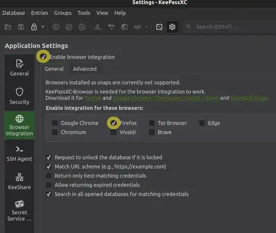

Earlier answers are no longer relevant as Native Messaging support arrived in Stable Version of Firefox Snap around November 2022. Firefox snap is now unlikely to be the cause of the browser integration failure.
Ubuntu software app might install keepassxc as a snap and keepassxc snap does not support native messaging (and seems unlikely to do so anytime soon). If so, remove the snap version and reinstall keepassxc as a ppa for browser integration to work.
  • Remove keepassxc using Ubuntu Software app
  • sudo add-apt-repository ppa:phoerious/keepassxc
  • sudo apt update
  • sudo apt update
  • Start keepassxc and go to Tools -> Settings -> Browser Integration
  • Select Enable browser integration and Firefox)
