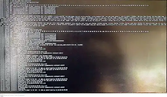

I updated to Ubuntu 22.04 and there is something wrong when I suspend my computer: I have that screen:

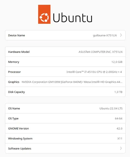

I'm using NVIDIA driver (nvidia-driver-470) and I'm on X11 and since the update I can't switch to Wayland anymore from the login session.

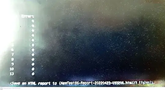

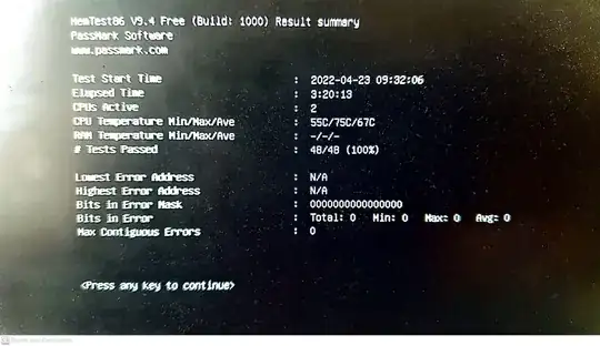

I think i don't have ram issues according to memtest :
memtest enter image description here

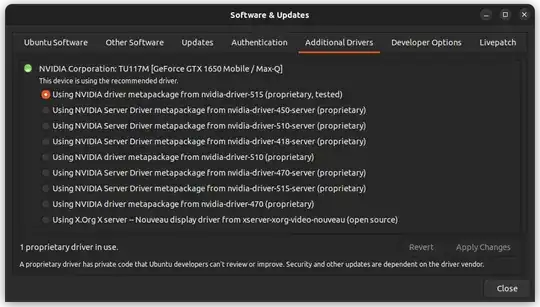

I have a Dell XPS 7590 (GeForce GTX 1650) and had the same problem.
For me it was resolved when I changed the used driver from X.Org X Server to NVIDIA driver metapackage from nvidia-driver-515.
Everything is working now using Xorg (ubuntu on xorg from gdm) with nvidia-driver-510 (from additional drivers).
