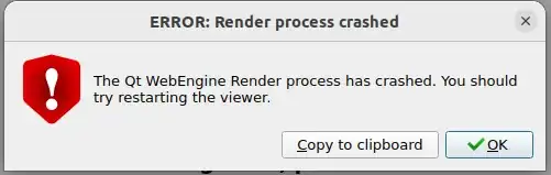

Just upgraded to 22.04 and the ebook viewer is unable to open .mobi file with ebook viewer error message:
calibre, version 5.41.0
ERROR: Render process crashed:
The Qt WebEngine Render process has crashed.
You should try restarting the viewer.
I've tried this before and after Calibre update and is getting the same result.
