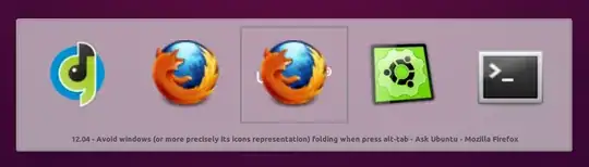

In 12.04 when I press Alt-Tab and had opened more than one... lets said firefox windows, I just can see one firefox icon that represent all the firefox windows I have open.
How can I get one icon per windows instead of one icon per windows of the same type when I press Alt-Tab ?

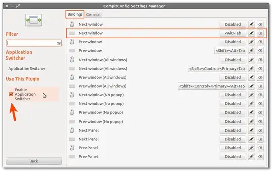

This can be done in CompizConfig Settings Manager using "Application Switcher".
Install CCSM:
  • Hit Alt+Ctrl+T to open terminal and run following command:
    sudo apt-get install compizconfig-settings-manager
    Or search for compizconfig-settings-manage in Software Center and install from there.
How to have a Windows like Task Switcher?
  • Once installed, Hit Super key (Windows key) to open Unity dash and search for "ccsm" and open it.
  • In CCSM navigate to Windows Management > Application Switcher.
  • Enable "Application Switcher", You'll see a warning window click on "Resolve Conflicts" and disable all "Unity Plugin" bindings. Change the key binding for "Next Window" to Alt+Tab.
  • Click on "General" tab. and enable "Only Show Icons".
  • Close CCSM. That's it!
Now in "Application Switcher" you'll see a septate icon for each window of an application.
