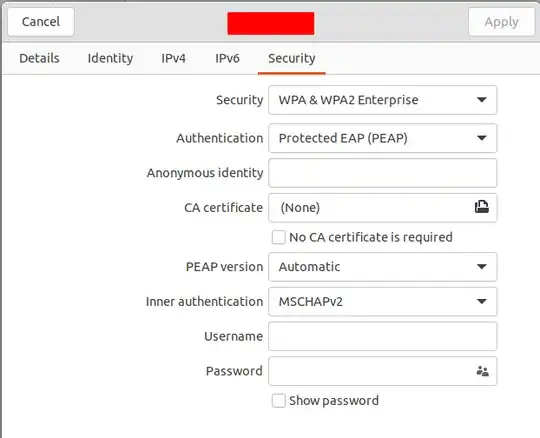

Wireless Security configuration is:
WPA and WPA2 Enterprise, authentication is PEAP with CA certificate. Inner authentication is MSCHAPv2.
Solution was:
They (IT) seemed to randomly change the CA certificate yesterday evening without informing anyone. Now its USERTrust RSA Certification Authority instead of DigiCert Assured ID Root CA.
