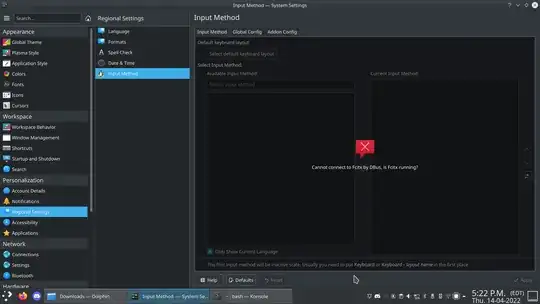

When I open Input Method settings in KDE plasma and it showed "Cannot connect to Fcitx by DBus, is Fcitx running?" and I can't do any changes to input method since everything is grayed out.
Only "Input Method" tab affected. "Global Config" and "Addon Config" works fine:
"Screenshot 1"

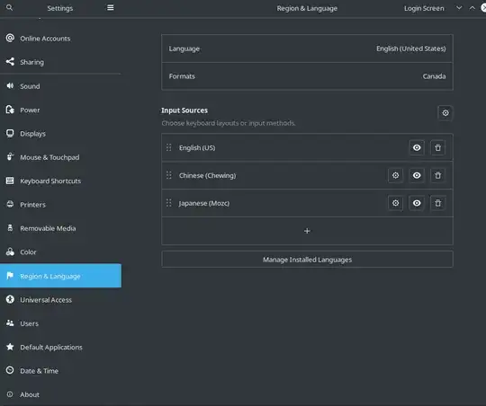

Language support settings in Gnome:
Screenshot 2
Region & Language settings in Gnome settings:
Screenshot 3

I had this problem today with kubuntu 22.04 after some updates. The keyboard was acting strange and I have noticed this error message on the keyboard layouts dialog.

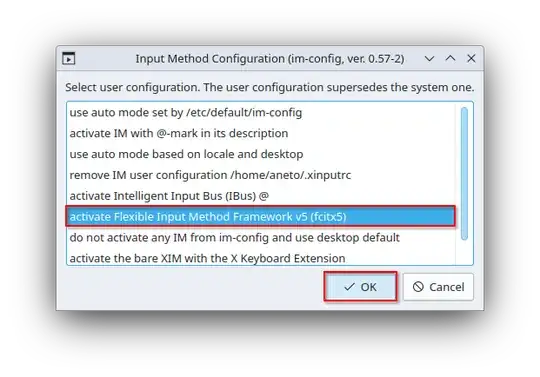

I have solved it by going to Input Methods.
Clicked OK on the first dialog:

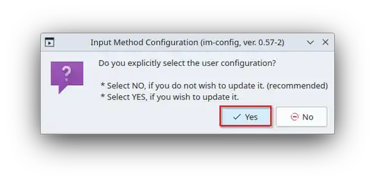

Clicked Yes to explicitly set a user configuration.
Finally, I choose Activate Flexible Input Method and pressed Ok
After this I have rebooted and all was working correctly.
