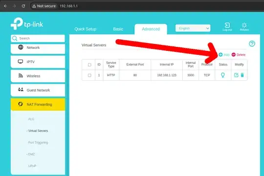

Sample TP-Link Archer VR2800 setup
The "hard" part is setting up the router.
For example, after I got the Internet to work on my TP-Link as mentioned at: https://www.youtube.com/watch?v=7vqVVlEFnV4 then I had to visit http://192.168.1.1 login and go:
  • Advanced
  • NAT Forwarding
  • Virtual servers
  • Add
My sample screenshot is forwarding external port 80 to my computer with internal IP 192.168.1.123 port 3000 as it is a web server.
For SSH you would likely keep it 22 external to 22 internal.

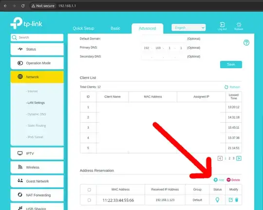

Then I fixed my home computer to always have that same IP with a static IP reservation:
  • Advanced
  • Network
  • LAN Settings
  • Address reservation
and I fix the IP of my computer to be 192.168.1.123. I identify the computer using its MAC address, which is a unique hardcoded hardware identifier of each network interface.
