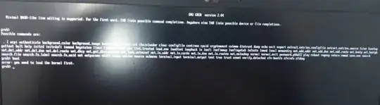

I enter BIOS setup and make save boot off and when I select the boot device, booting from my USB drive this is what happens:
A Grub console shows up, and then when I write boot guess what:
error: you need to load the kernel first.
Where is the way to proceed? I really need to install Ubuntu

it turns out that this was an inherited grub from a dual boot windwos 10/linux mint. All I had to do was select my boot options and select usb booteable device and all was ok to continue from there, Now I have ubuntu installed
