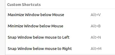

Set custom keyboard shortcuts:
Custom shortcuts
And then use them in logiops setup:

              keys: [ "KEY_LEFTALT", "KEY_M" ]; // snap window to right
