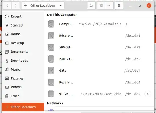

I have a problem with the "computer" space. I get constantly an error message signaling the lack of space. There are several drives on the computer, one with Windows OS on it, with a lot of space, how can I use some of those spaces to increase the size of the root drive?
a view of PC drives

What can I do?
Here is what I get with df -H:

When I get a popup signaling a shortage of space if I ask an examination I get the following circular diagram: enter image description here

This computer looks like a bit of a mess but let’s try to help you.
sda looks like it was once a MBR Windows installation but may be just a data disk now.
sdb looks like it is another Linux installation but not the one you are having the space problem with. It could be Linux data but it doesn’t appear to be mounted.
sdc looks like Windows data
sdd has your Linux installation and another Windows partition. It may be a Windows data partition or could be a Windows system partition.
There are several ways you could simplify this but to just answer the question the following should give you more space for Linux. This assumes you can spare some space from sdd2, a Windows partition.
  1. Backup any data on sdd that you cannot afford to lose
  2. Ideally using Windows disk management, shrink sdd2. It looks like you might be able to shrink it by up to 40GB.
  3. Boot your machine with a live environment that contains GParted. The Ubuntu install media is ideal. Choose Try Ubuntu and then run GParted
  4. There should now be space between sdd2 and sdd3. Using GParted move sdd3 all the way to the left and click apply.
  5. The space should now be between sdd3 and sdd4. Using GParted extend sdd4 all the way to the left into that space and click apply.
  6. You should now be able to move sdd5 all the way to the left and apply
  7. Finally extend sdd5 all the way to the right.
Once these steps are complete reboot into the computer’s Linux installation which should now have extra space for /. Any problems comment below . Good luck
