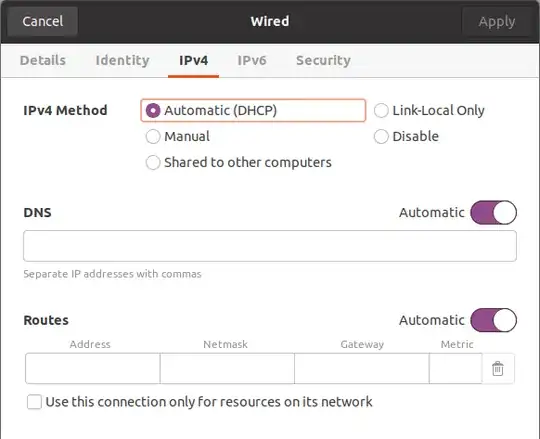

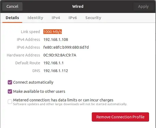

Right after login, my network manager connection looks like this, which was identical when everything was running fine:
After running sudo dhclient, I have network but the network-manager settings haven't changed.
