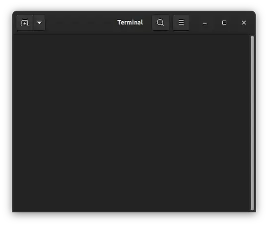

I was trying to kill responded window so I used kill -9 PID and the PID was the ID of /usr/libexec/gnome-terminal-server by mistake. Now, every time I start terminal (even if it is a virtual terminal) it doesn't show anything as shown in the image below
and then I need to press CTRL+d to begin using shell.

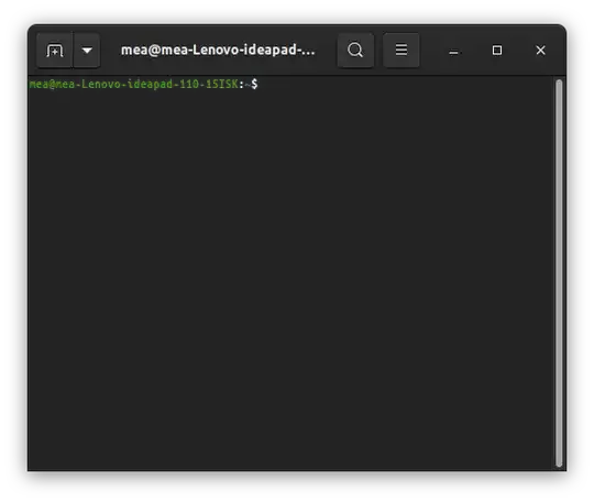

After clicking CTRL+d :
