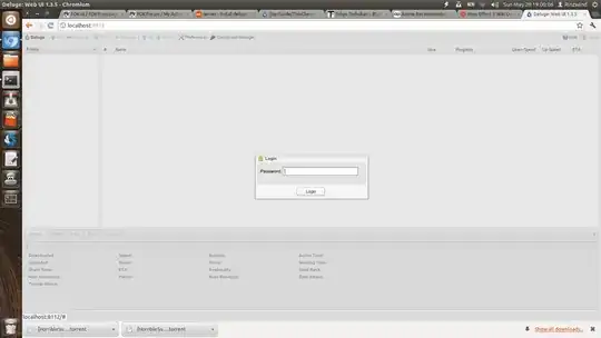

You also need to start deluge-web. Or deluge-web --fork if you want the process to be started in the background. Then open a browser.
Go to
http://localhost:8112
Password should be deluge.
