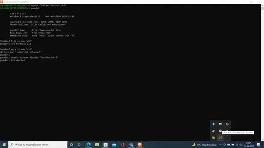

I can't run gnuplot x11 terminal from Ubuntu 20.04 from Microsoft Store. I installed Ubuntu from Microsoft Store, then I installed VcXsrv. Then I run Xlaunch (VcXsrv) - choose display settings multiple windows, Start no client (I also tried with parameter -ac), then I choose Clipboard, Primary selection and native opengpl and finish. Then I run Ubuntu from Microsoft Store on terminal write export DISPLAY=localhost:0.0 then gnuplot then set terminal x11 and I get error Terminal type is now 'x11' Options are ' nopersist enhanced' gnuplot> gnuplot: unable to open display 'localhost:0.0' gnuplot: X11 aborted. Why? enter image description here

Thank you so much. It works, I also got an error:
gnuplot> plot sin(x)
Authorization required, but no authorization protocol specified
gnuplot: unable to open display 'DESKTOP-U0BQ8NT.local:0.0' gnuplot: X11 aborted.
