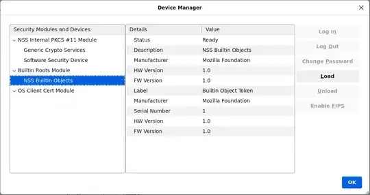

By default, Firefox uses its own certificate store, which contains hard-coded root CAs. On the first start, these certificates are copied into the users Firefox profile. For these builtin certificates a PKCS-11 module is used:
Firefox default PKCS-11

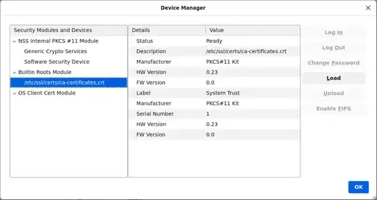

After these steps restart Firefox and checkout the PKCS-11 module and the registered root CAs:
p11-kit module
If the trusted root CAs are modified by sudo dpkg-reconfigure ca-certificates, all Firefox instances will be affected immediately.
