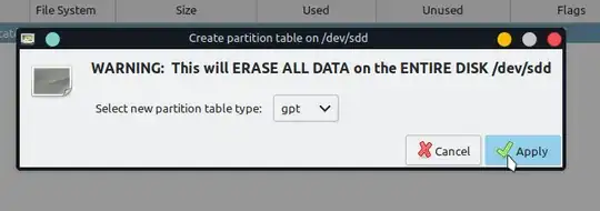

You might have different devices. Just check which device has the right capacity. Make sure the partition is unmounted. If it isn't right click the partition and click on "Unmount". Then click onto "Device/Create Partition Table...". It will warn you so make sure you have selected the right device. You can choose between some different partitioning tables. I would recommend either msdos, gpt or mbr (mbr is the default one for flash drives so you should probably select that one). Then click on "Apply".
Create new partition table

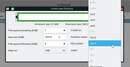

After that, right click onto the unallocated space and click on "New". Give the partition a name (and maybe a label) and select FAT32 for the filesystem.
Create the partition
