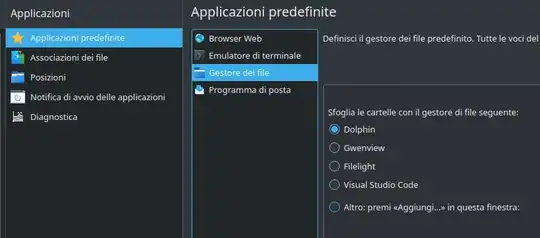

I am running Kubuntu 20.04 and Flatpak 1.6.5. Dolphin is my default File Manager enter image description here
when I open a directory from a Flatpak app such as DropBox or Cryptomator, it opens it in Visual Studio Code instead of Dolphin. This doesn't happen if I open a directory from a non Flatpak app. Also xdg-open ~ as expected opens Dolphin. So it seems to be a Flatpak issue.

I see this is a few months old now, but I found this looking for the same issue. In my case, a flatpak app was opening VS Code but only in some situations and other it was correctly opening my file picker. I'm using KDE so I wanted it to always open dolphin but it was a GTK flatpak so I thought that might be the issue. Turns out, it's because VS Code prepends itself to inode/directory in /usr/share/applications/mimeinfo.cache. Moving VS Code to the end of that line and dolphin to the start fixed the issue. Note that dolphin did show as the default in the settings app. My guess is KDE versus GTK, the settings app only showed the KDE settings and the flatpak was searching the GTK way. Or something.
