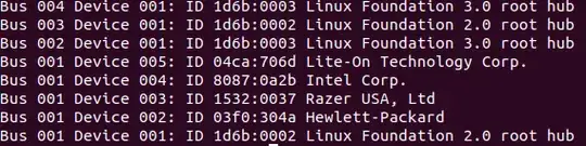

With respect to USB ports: Output of lsusb enter image description here
Not sure why it shows 3 USB ports, the laptop only has 2...
