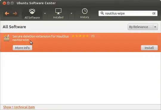

  • Go to the Software Center, search for nautilus-wipe, and install it.

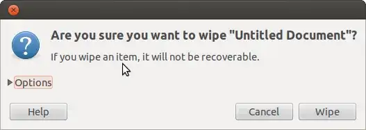

  • If you click on wipe, you will see the following:

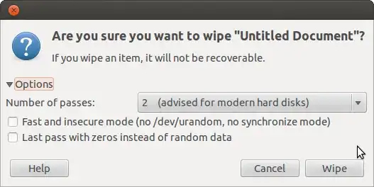

  • You can configure the options (type of wipe, number of passes, etc.) by clicking on the Options triangle:

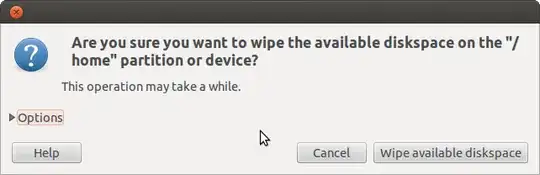

  • Clicking Wipe Available Diskspace on any item or within empty space in Nautilus will offer to wipe free space on the that partition:
