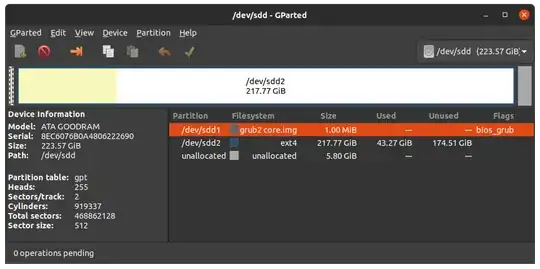

Here is the SDD geometry as reported by gparted.
