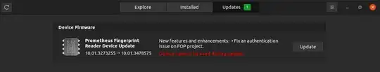

I rarely use the Ubuntu Software application, but when I opened it today I saw that it has a notification saying that my fingerprint scanner firmware can be updated.
Software center updates
However, the apt upgrade and snap refresh commands output that everything is up-to-date. Am I missing a third source of packages on my system?

Thanks to @Ponjar's and @oldfred's comments, it turns out there's another manager that manages device firmware updates called fwupd.
Short version
To update device firmware, you can run the following command:
$ fwupdmgr update

Perform operation? [Y|n]: Downloading… [***************************************] Downloading… [***************************************] Decompressing… [***************************************] Decompressing… [***************************************] Authenticating… [***************************************] Authenticating… [***************************************] Restarting device… [***************************************] Writing… [***************************************] Scheduling… [***************************************] Decompressing… [***************************************] Restarting device… [***************************************] Waiting… [***************************************] Successfully installed firmware Do not turn off your computer or remove the AC adapter while the update is in progress.
An update requires a reboot to complete. Restart now? [y|N]:
At this point, you should reboot the system. Either choose y above, or run reboot, or use the GUI menus to reboot. When the computer gets to the BIOS flash screen, it will automatically begin applying the firmware updates, as shown here:
Once you finish rebooting, run fwupdmgr get-updates one more time and choose "Yes" to upload a report to the manufacturer to help them improve their firmware ugprade process. You'll see this request: Upload report now? (Requires internet connection) [Y|n]. Here is the full run and output after the reboot:
$ fwupdmgr get-updates
Devices with no available firmware updates:
 • PC801 NVMe SK hynix 1TB
 • SSD 970 EVO Plus 2TB
 • TPM 2.0
 • UEFI Device Firmware
 • VEN 04F3:00 04F3:311C
 • Fingerprint Sensor
 • UEFI dbx
Devices not currently updatable:
 • System Firmware — Cannot install update when not on AC power
________________________________________________
Devices that have been updated successfully:
• System Firmware (1.13.1 → 1.18.0)
Uploading firmware reports helps hardware vendors to quickly identify failing and successful updates on real devices. Upload report now? (Requires internet connection) [Y|n]:
If you run fwupdmgr update now (or even before the reboot above, for that matter), you'll see that everything is up-to-date. Here is an example run of fwupdmgr update again on my system after performing the above upgrade via fwupdmgr update. All firmware now either has no updates available, or is already up-to-date:
$ fwupdmgr update
 • TPM 2.0
 • UEFI dbx
Devices with the latest available firmware version:
 • System Firmware
And, if you run fwupdmgr get-updates again now, you'll see No updates available at the very bottom of its output, as shown here:
 • TPM 2.0
 • UEFI dbx
 • System Firmware
