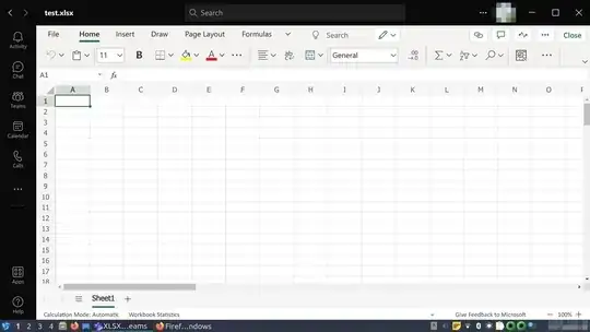

You can use the Office365WebDesktop Snap.
sudo snap install office365webdesktop --beta
image Image source

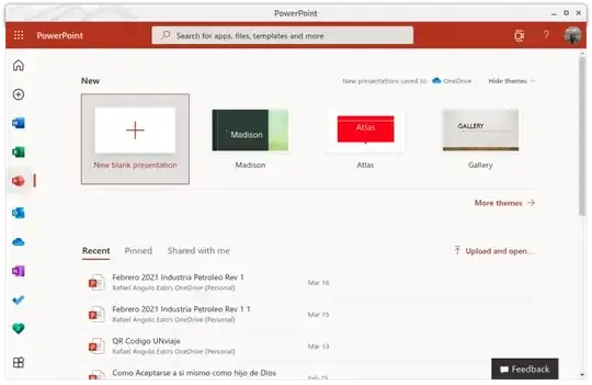

I use Lubuntu, not sure how this looks on Kubuntu. If you have a OneDrive account, you can use the official .deb of Microsoft Teams to manage Office documents. Once logged in, click on "Files" on the left (it may be under the ...), and under "Cloud Storage" there should be the "OneDrive" folder, where you can create and edit documents. The UI is almost identical to the Desktop version: enter image description here
