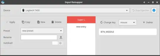

I have tried with the application Input Remapper with this configuration: enter image description here and it works as I want, but it breaks the soft scroll of the mouse so it is not a solution to me.
