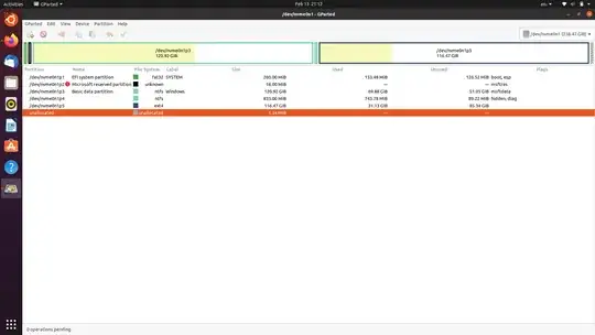

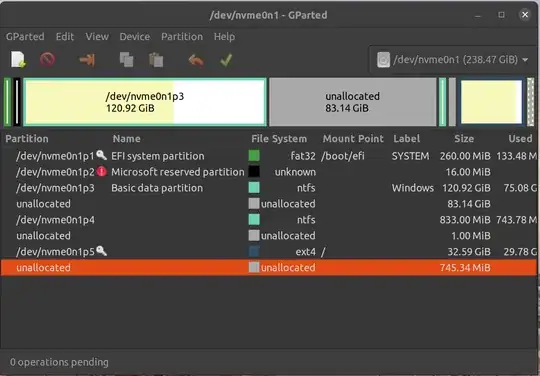

I have installed Ubuntu 20.04 alongside Windows 11, initially giving Ubuntu 33GB. Now I want to install larger programs, thus my 33 GB are not enough. I went on Windows and I removed 80 GBs from the Windows partition, now I am on Ubuntu and I have no clue on how to give these 80GBs to the Ubuntu partition to increase the storage space inside of the OS to install larger programs. The blue square (/dev/nvme0n1p5) is the Ubuntu partition.
How can I allocate the extra space I made to Ubuntu?
Screenshot of GParted
second screenshot
Last screenshot
Make sure that you have a good backup of your important Ubuntu files, as this procedure can corrupt or lose data.
Keep these things in mind:
  • always start the entire procedure with issuing a swapoff on any mounted swap partitions, and end the entire procedure with issuing a swapon on that same swap partition
  • a move is done by pointing the mouse pointer at the center of a partition and dragging it left/right with the hand cursor
  • a resize is done by dragging the left/right side of a partition to the left/right with the directional arrow cursor
  • if any partition can't be moved/resized graphically, you may have to manually enter the specific required numeric data (don't do this unless I instruct you to)
  • you begin any move/resize by right-clicking on the partition in the lower pane of the main window, and selecting the desired action from the popup menu, then finishing that action in the new move/resize window
Do the following...
Note: if the procedure doesn't work exactly as I outline, STOP immediately and DO NOT continue.
  • boot to a Ubuntu Live DVD/USB, in “Try Ubuntu” mode
  • start gparted
  • move /dev/nvme0n1p4 partition all the way left
  • move /dev/nvme0n1p5 partition all the way left
  • resize the right side of /dev/nvme0n1p5 all the way right
  • click the Apply icon
  • reboot to Ubuntu and confirm free space
  • boot to Windows to confirm that it still boots
