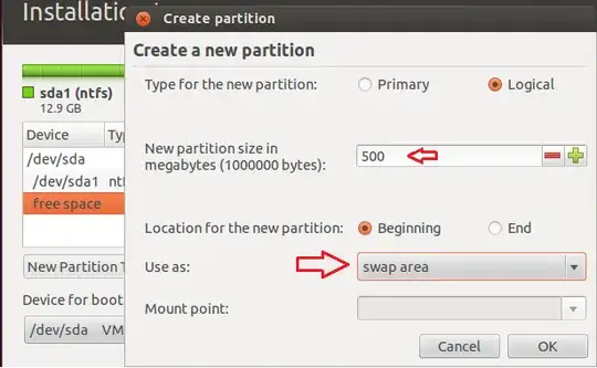

Step 1 : Create a SWAP partition
  1. Select the new unallocated space or free space, click on add.
  2. Assign the space from that partition to SWAP AREA equal to double your ram.(e.g-for 1gb,swap area-2gb)
  3. Select SWAP AREA from the file system drop down menu.
  4. Make sure Beginning is selected in the partition position drop down menu.
  5. Click on add.

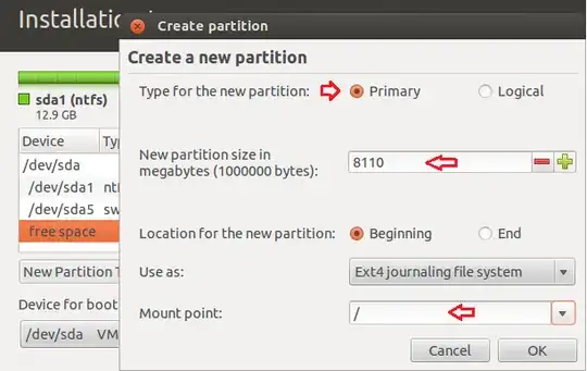

Adding root file system
Now, after you have added the SWAP AREA,do this-
  1. Select the remaining "Unallocated space" and click on ADD.
  2. Select Ext4 Journaling file system from the file-system dropdown menu.
  3. Select Primary from the partition type drop-down menu.
  4. Select the mount point as / from the mount-point drop-down menu.
  5. Select beginning from the Position drop-down menu.
  6. Click on add.

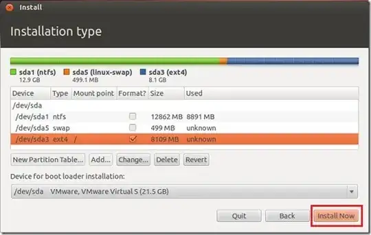

After adding the partitions,from the table select the ext4 partition you see and tick in the corresponding check-box(if not already ticked) enter image description here
then Select INSTALL...
