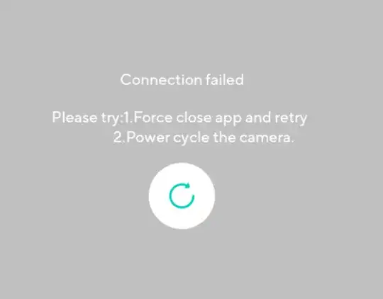

  5. Log in to the Wyze App, and click on the camera stream you'd like to view. If you get this error message:
    Connection failed.
    Please try:1.Force close app and retry
    2.Power cycle the camera.
    ...then:
    1. first, power cycle the camera by unplugging it and plugging it back in. Go back a step in the app and try viewing the livestream again. If that works, great! If not:
    2. close BlueStacks, reboot your Windows 10 virtual machine, then close Virtual Box, letting it save its state. Next, reboot your Ubuntu machine. When back in Ubuntu, open VirtualBox, open Windows 10, re-open BlueStacks, and try again.

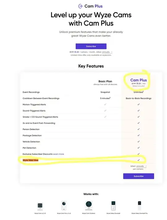

4. What I'll probably do next (buy a subscription and use Wyze Web View)
Update: I did this; it works awesome!; I can watch what's going on outside my house on my computer monitor. It works great!
It looks like they sell a subscription plan called "Cam Plus" for ~$2/camera/month: https://services.wyze.com/detail/camplus
It says it includes "Wyze Web View", which apparently lets you view your camera stream online in a browser (see the quote below). That may be worth buying.
I like FOSS software for sure, but I understand that a subscription plan is how companies like Wyze stay alive so they can pay their employees and keep on innovating. I'd rather have them require a small subscription fee to keep improving their firmware and software than have them in dire financial straits where they are motivated to make your camera "break" every 2 years so you'll buy a new one, for instance (like Crapple does, even though they are not in dire financial straits, and they have really high profit margins).
Here is a pertinent quote about Wyze Web View (emphasis added): https://support.wyze.com/hc/en-us/articles/4409136365595-Wyze-Web-View-FAQ:
Wyze Web View FAQ
Brenda
February 15, 2022 12:53
What is Web View (View on Browser)?
Wyze Web View will be a convenient way to access your Wyze Cam's live stream and Event Playback through a web browser. You'll be able to use Web View in a browser on a PC, Mac, Smart TV, tablets, etc.
What browsers are supported?
The latest versions of Chrome, Safari, Edge. Firefox is not supported yet in Beta, though we are working on adding it asap.
Which devices are supported?
The ability to view the live stream and Event videos are available on Wyze Cam v2 and v3, and Wyze Cam Pan v1.
Do I need Cam Plus to be able to use Web View?
During testing, yes. Wyze Web View will only be available to Cam Plus users.
It looks like buying a Cam Plus subscription to get the Web View feature would be a pretty worthwhile expenditure.
