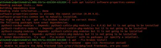

I have this problem and I don t know what to do, I have tried a couple of things but I am stuck. Can you help me please. enter image description here

The specific problem you are encountering is indeed a clear duplicate of dpkg error: "trying to overwrite file, which is also in...", but there's an underlying problem: Your system has lots of newer software from several non-Ubuntu sources bolted onto an older LTS. We call this a "Frankensystem".
  • LTS releases are stable and secure for five years if you don't change the software.
  • Frankensystems tend to be unstable, and the various sources often provide packages that conflict with each other...which is exactly the problem you have.
  • Generally, most folks who want newer software will get the best experience if they use a newer release of Ubuntu --or-- install the newer software using a snap instead of a deb.
