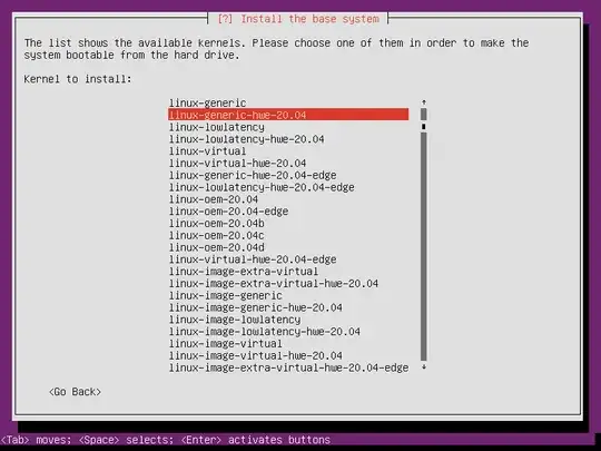

Important: to install HWE kernel 5.13 into target system one should boot using Advanced Options → Expert Install, follow wizard as usual and then on the Install the base system screen select linux-generic-hwe-20.04 kernel to install
then proceed with GRUB installation and so on.
