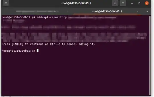

In recent releases of Ubuntu, adding a PPA automatically updates the package cache immediately.
Sometimes, I need to add several PPAs (e.g. after a new installation), and would like to manually run apt update in one go, after adding all the PPAs.
How to do that?
I found this question, which suggests using add-apt-repository -n ppa:user/repo.
How to change the default behavior so that the package cache will not be updated even when the -n flag is not supplied?
For example, in Linux Mint, the package cache is never automatically updated after adding a PPA. How to make that the default behavior in Ubuntu?
