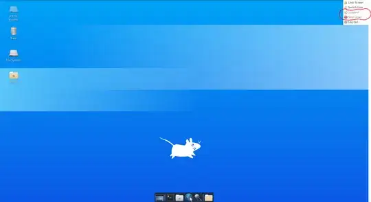

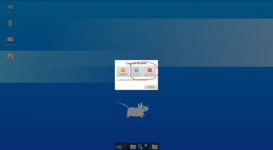

With a clean Ubuntu 20.04 LTS Server running GNOME, everything is working fine when I physically log into the unit. But when I RDP into it as xfce4, the Restart, Shu Down, and Suspend button are all greyed out! The only button that is available is Log Out.
Screenshot 1
Screenshot 2
How can this be fixed so I can shutdown, suspend, or reboot via Remote Desktop?
